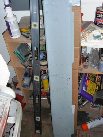

Zaney   After the passenger long was repaired on the inter...   Apr 24 2009, 10:23 AM

Zaney   Thanks Jon! :D Welded up the passenger long ...   Apr 24 2009, 09:38 PM

Zaney   BTW, got the camera and the passenger long repair ...   May 10 2009, 12:03 AM
