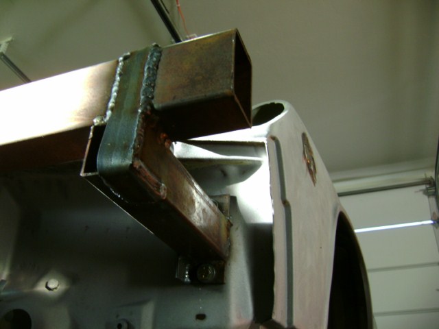

Cire   = ) Things are moving along. Are these added or ...   Nov 14 2009, 09:23 AM

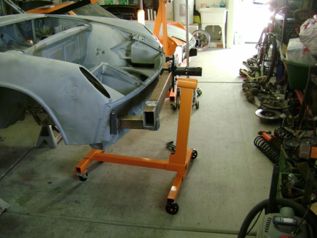

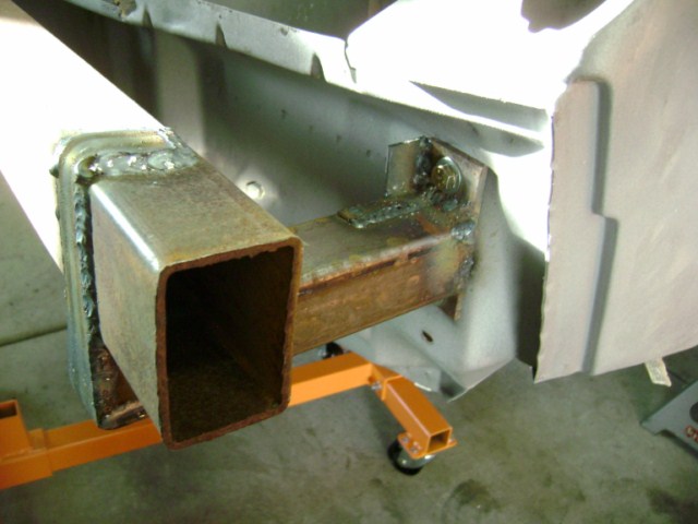

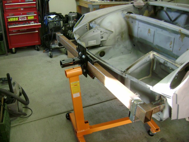

Cire   I decided to brace the sitting area. Here is my w...   Nov 18 2009, 08:30 PM
Cire   I also decided to build a Rottisserie. Eric ...   Nov 18 2009, 08:32 PM

strawman   Nice progress! I would suggest that you consid...   Nov 20 2009, 09:46 AM
Vacca Rabite   :agree: Widen the stance. You really don't ev...   Nov 20 2009, 11:32 AM
bigkensteele   :agree: Widen the stance. You really don't e...   Nov 20 2009, 12:39 PM
Vacca Rabite   I was at HF this morning looking at engine stand ...   Nov 21 2009, 11:43 AM
Cire   I got 90% of my welding done. Most of the holes a...   Nov 30 2009, 07:38 AM
