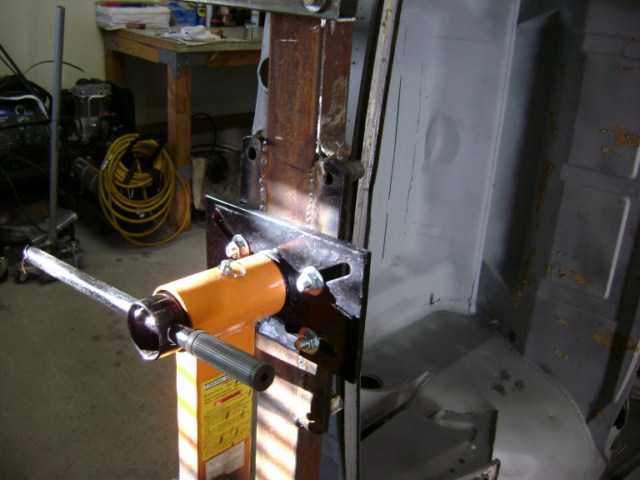

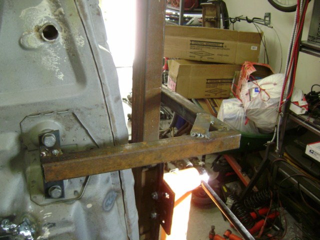

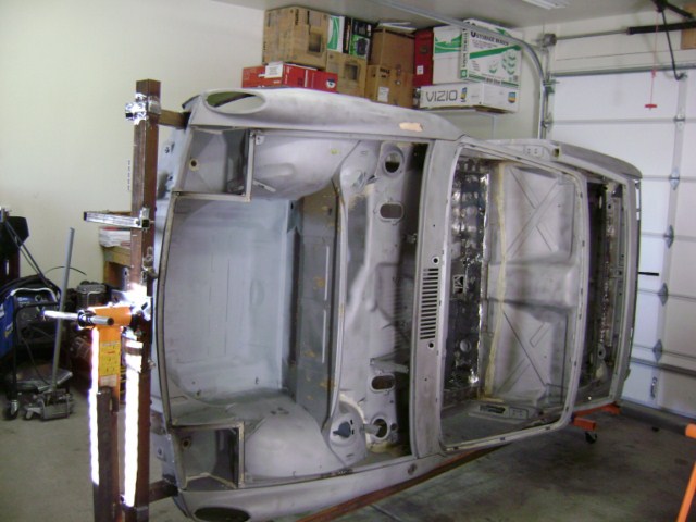

Howdy All,
This is the start of a new thread and the progress I am making on this little 914 car. First off, let me give you a little history. I had a WANTED ad in the craigslist area for Tucson and PHX. I got a call from a man stating he had a 914 that he wanted 1500 bucks for. We talked about the car. It ran, drove and he said it would make the drive to Tucson. We talked a little more and we determined he would take 1300 bucks for it. I arrange a rental car, drove to Prescott, dropped off the rental and then met the guy. It was a little rough at first but the car did start and drive... Well? No. Badly... Yes. I decided to go for it and started out the drive. It did infact make it all the way home in the heat of the day and over the mountains. = ) Anyway, so its now home, on stands and ready to begin its new life. Here are some pictures to start the thread.

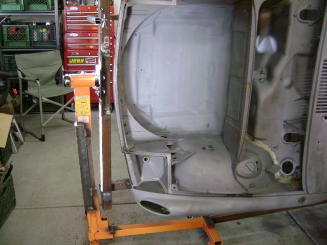

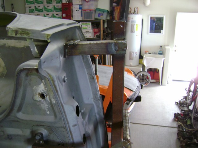

Widen the stance. You really don't ever want it to tip.
Also, put in t a cross bar between the two engine stands. This ties it all together and allows you to move the car around on the Rot in your shop. Very helpful in my build. I tried to do it your way first (no cross bar) and the whole thing almost folded the first time I tried to push it.

Cire
post Nov 20 2009, 05:08 PM
Posts: 279
Joined: 12-March 09
From: Tucson, Arizona
Member No.: 10,155
QUOTE(Vacca Rabite @ Nov 20 2009, 10:32 AM) *
Here is how I did it, using the same building blocks that you are using:
With the cross bar...
All taken care of sir. = ) It is stronger with that piece connecting the two engine stands. Having the car on the rottisserie really gives you some different looks at the cars. Things you didnt see before jump out at you now. Its also much easier to get to some things. I cant wait to start the electrical with the car in the air. I can put it on its side and work standing up verses bent over. = )
