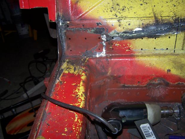

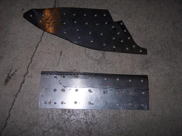

The original hell hole repair put that little patch on the firewall over the long. It's thin metal. I can't tell if 18 or 20 gauge. So I will put a support plate of 16 gauge over it.

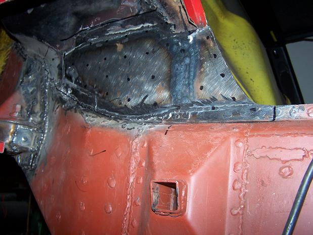

Same thing with the inner fender wall. Another plate of 16 gauge will cover this area although it has a 2nd purpose. The front part of the plate makes up the seam around the door where the weatherstipping goes.
Plates ready to go.

Spoke   The original hell hole repair put that little patc...   Nov 21 2009, 08:43 AM
Spoke   And Presto! The 2 plates may add a little bit ...   Nov 21 2009, 08:48 AM
