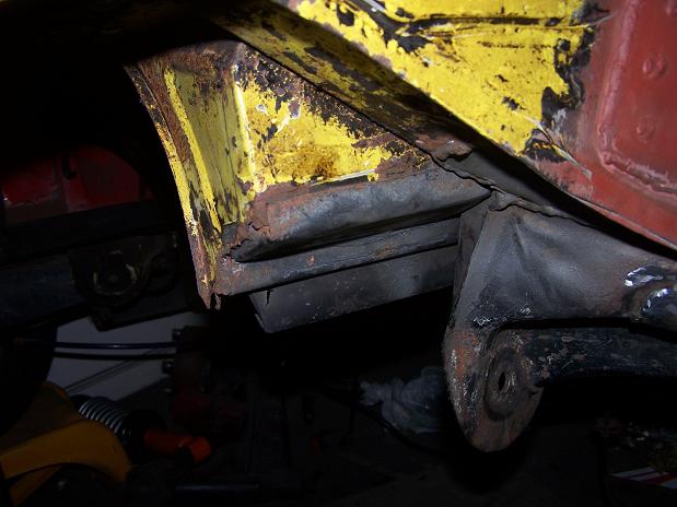

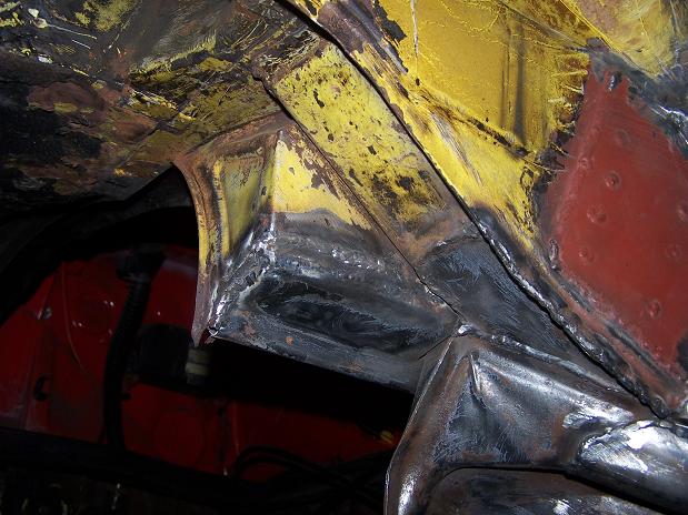

The passenger side engine shelf is a replacement. Here's the backside of the replacement engine shelf folded up under the existing metal.
It's a lot more fun welding 16 gauge steel versus half rusted 18 or 20 gauge, whatever the engine tin is. Also seam welded the part of the long over the rear suspension.
That looks better.
