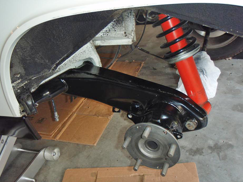

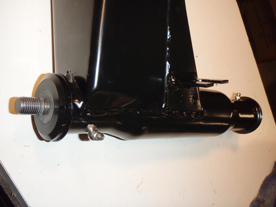

I'm half way there with the five lug installation. Yesterday, I installed the rear trailing arms. As you can see from the pictures, I installed the rear trailing arms bushings from PMB, and added zerks.
Also took the time to replace the SS braided brake lines the previous owner had installed with rubber lines.
