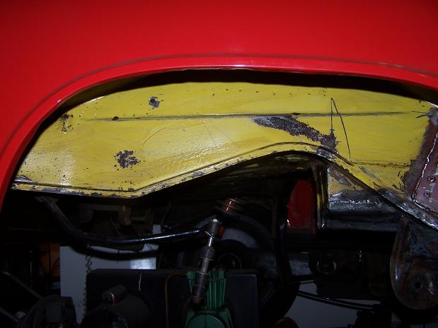

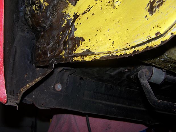

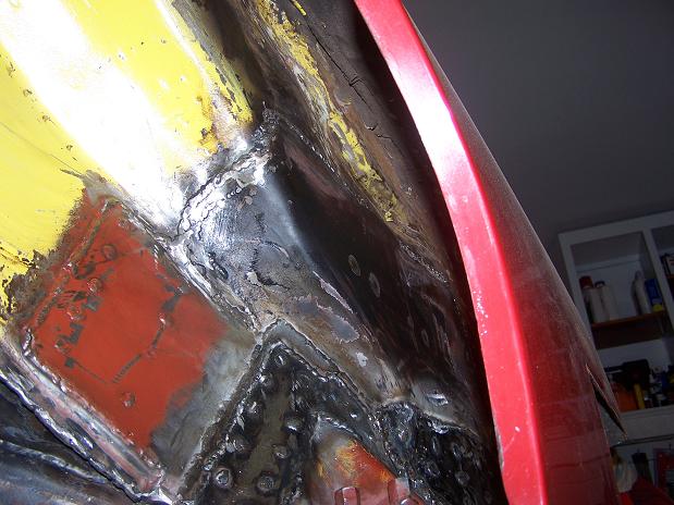

Prepping for paint. I either have a red car or a yellow car painted red.
The wrinkled inner fender near the rear is where the damage was from the rear end accident.
