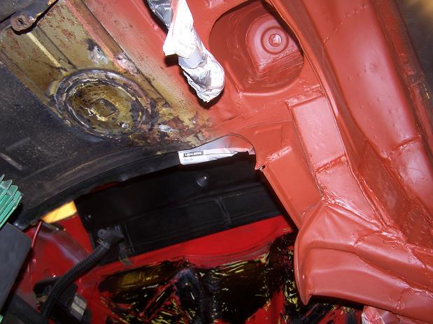

Primer going on now. Just painting the inner fender and bottom of the trunk floor around the shock. I'm only painting the areas that I am working on. I'm trying to avoid the "While I'm in there" syndrom. At least this corner will look good...

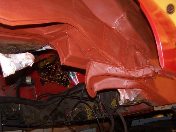

The wrinkles and surgery from the accident repair are noticible in this pic.
I'll paint the rest of the trunk floor when I turn the car around in the garage and work on the driver's side.
