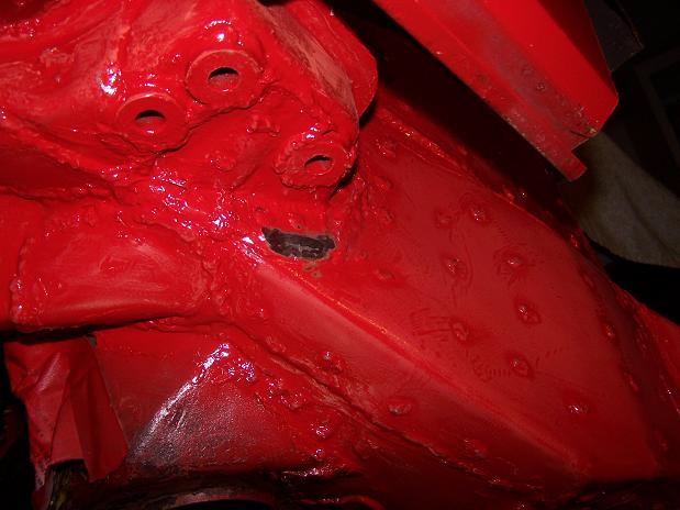

Had paint on then decided to fit the swing arm mount and had to make some clearance. This is the consequence of adding plate after plate onto the long.
