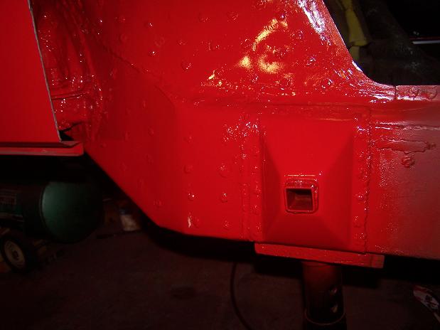

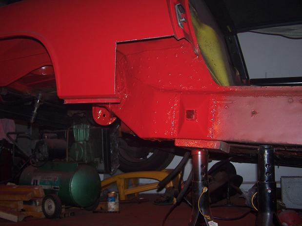

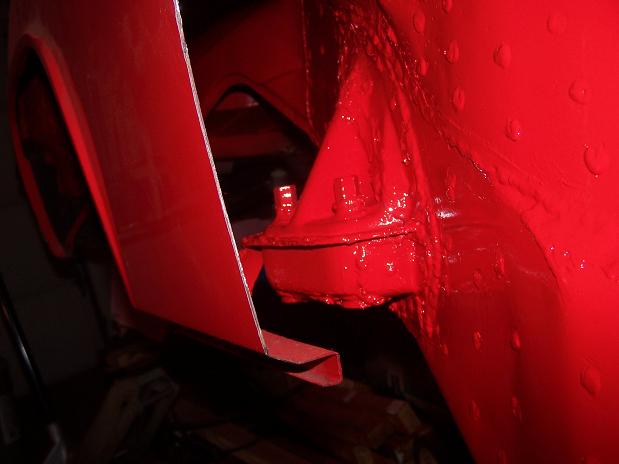

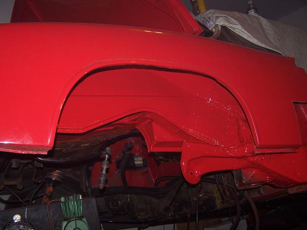

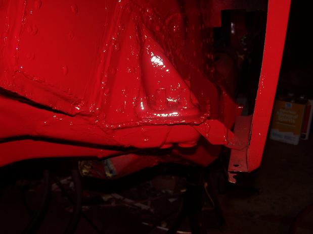

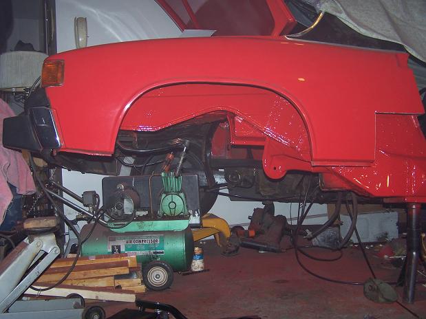

Got the paint finished tonight. Feels like I'm painting the outside of the car. Most of this work will never be seen once the fender is back together.
