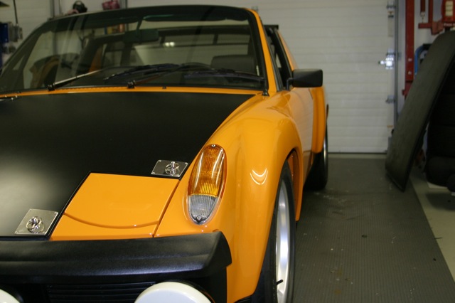

badm
post Nov 27 2009, 07:10 AM
Posts: 213
Joined: 10-May 09
From: Cape Cod Taxachusetts
Member No.: 10,350

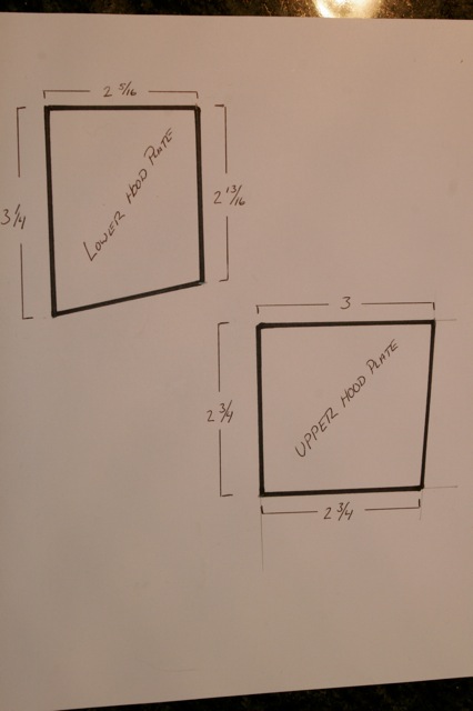

I got my hood pins from www.jegs.com in stainless steel and had the plates cut from 14ga SS at a local sheet metal shop for about $15.00, spend some time to round the edge and use some SS pop rivets and it will look fantastic. Pm me and I will get the size and shape of the plates to you, if you want. Ben
badm
post Nov 27 2009, 10:23 AM
Posts: 213
Joined: 10-May 09
Member No.: 10,350
QUOTE(badm @ Nov 27 2009, 05:10 AM) *
Plate size.

campbellcj   Thanks Ben, that helps a ton!   Nov 27 2009, 10:33 AM
