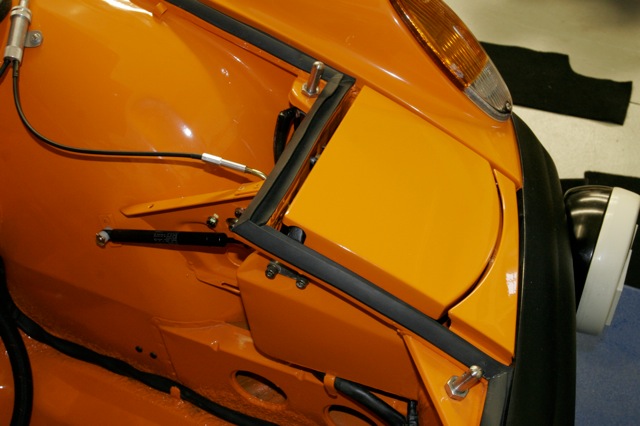

Looking for either turnkey kits with the base plates and pins, or I don't mind fabbing the plates if somebody has the 'proper' dimensions and angles etc. written up somewhere. I am not doing an authentic GT replica so I don't need factory parts or exact clones, but this is one area where I think it makes sense to stick as close as feasible to the way it was done on the real GT's.
Here's what I am talking about -
http://www.stazak.com/914/gt/hood/hoodplat.html
http://www.pbase.com/9146gt/image/24147550
My understanding is they are cut from stainless sheet metal and then the edges are folded over a specific way so as to 'bite' into the fiberglass lid a bit and probably also to give a little bit of spring vs. laying totally flat.
Any vendor links or fab tips appreciated.

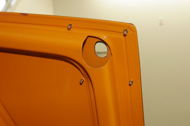

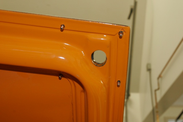

I was concerned that the backside of the rivets would come out into the stiffener. Do you have pics of the backside of the hood where they mount?
Thanks, John
Thanks, John
Photos of the back side of the hood. Ben
