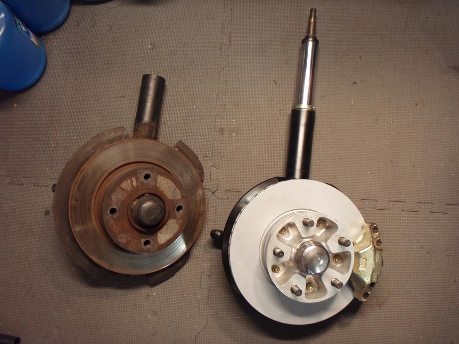

I bought a five lug set up today from a local guy off craigslist. The front is a Boge set up with 3" spacing and M-calipers. I already have a pair so I will most likely be selling these off in the near future.
It's the rears that got my attention. The hubs are originally five lug, not four lug redrilled for five. The guy who sold them to me took them off a 914 he parted out a long time ago and has been storing them ever since for an eventual five lug conversion. He sold them as he has too many projects as is.

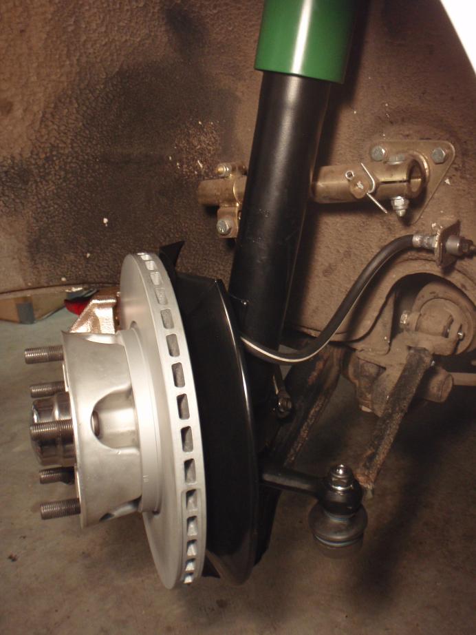

Installed the fronts. Also installed new ball-joints and tie rod ends as well. The old tie rod boots were ripped and who-knows-how-old. Steel braided lines were replaced with new rubber lines.
It worked out well that the new suspension was the later 911 strut that uses the wedge pin like the 914. I was able to simply transfer the Bilstein inserts.
The problem with putting new stuff on the car is that it makes the surrounding areas look that much dirtier. I have to scrub the inner wheel well this weekend. I previously had a cross member and A-arms powder coated, but opted to leave the existing pieces on the car and just replaced the struts. The power coated pieces will wait until I do a more extensive restoration on this car one day.

MrKona   I had to spend some today to see what I've got...   Feb 15 2009, 01:47 PM
my928s4   I had to spend some today to see what I've go...   Feb 15 2009, 03:18 PM

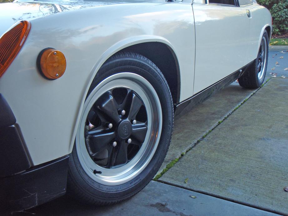

MrKona   I'm half way there with the five lug installat...   Nov 22 2009, 01:39 PM
MrKona   16x6 Fuchs. Two down, two to go.   Nov 22 2009, 01:42 PM

MrKona   Installed the fronts. Also installed new ball-join...   Nov 27 2009, 06:42 PM
SirAndy   Time to change my avatar! Check your rear ali...   Nov 27 2009, 06:53 PM
MrKona   Time to change my avatar! Check your rear al...   Nov 27 2009, 06:57 PM
