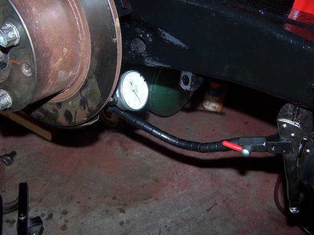

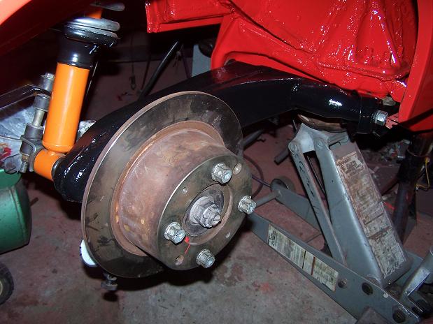

Putting the rear suspension back on. Had to spruce everything up with a coat of paint.
The garage must be relatively dry since the rotor is still shiny after sitting in the garage for over a year.
I checked the runout on the rotor. Not bad but not as good as I would like. The hub had a good bit of rust when I took off the original rotor and I never got the new rotor seated right and it always had some runout. I added a little 0.005 thick shim between the rotor and hub on the low side and it virtually cured all the runout.
