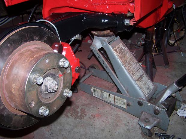

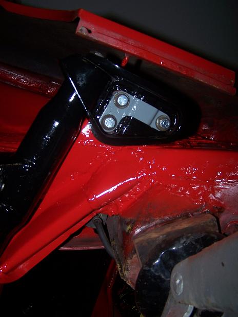

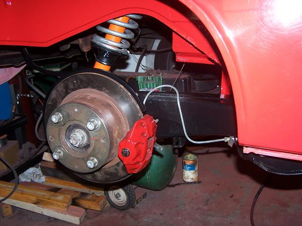

Spoke   Putting the rear suspension back on. Had to spruce...   Nov 30 2009, 12:05 AM
Spoke   Caliper on. I had plenty of clearance betwee...   Nov 30 2009, 12:10 AM
