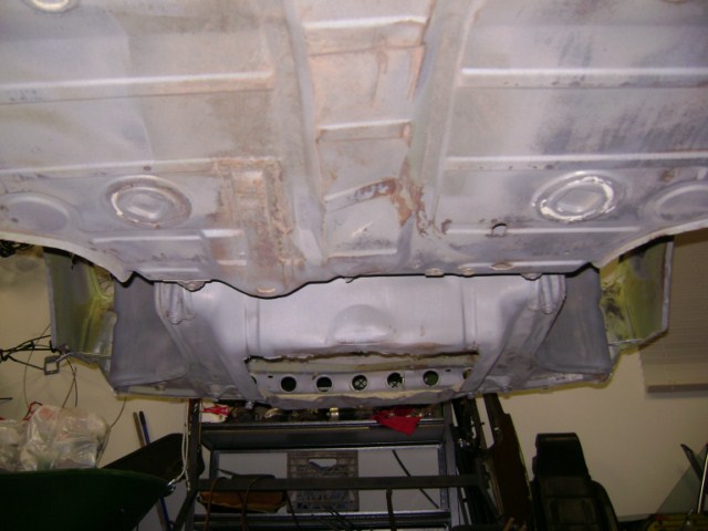

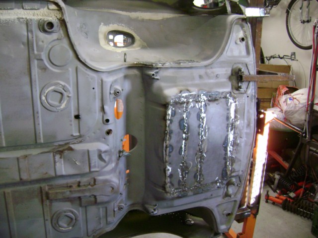

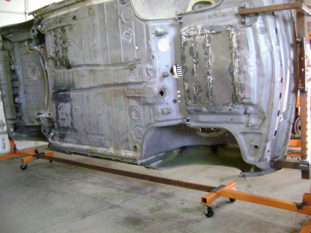

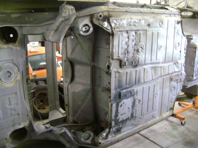

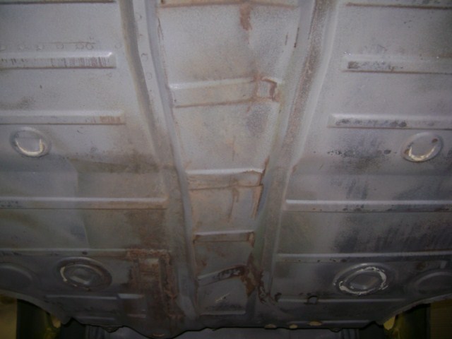

I got 90% of my welding done. Most of the holes are filled. All the rust has been removed except the small corner on the flag that I will tackle this week. My next challenge is the tunnel from the under side... do I need to fix it? The car worked great driving it but I dont want to have to open it up again later...
Here are some pictures. = )
Eric
It looks as though they hit a rock and the car bounced on it down the tunnel area... So there are really 2 maybe 3 areas that need to be pulled out if thats what needs to be done...
