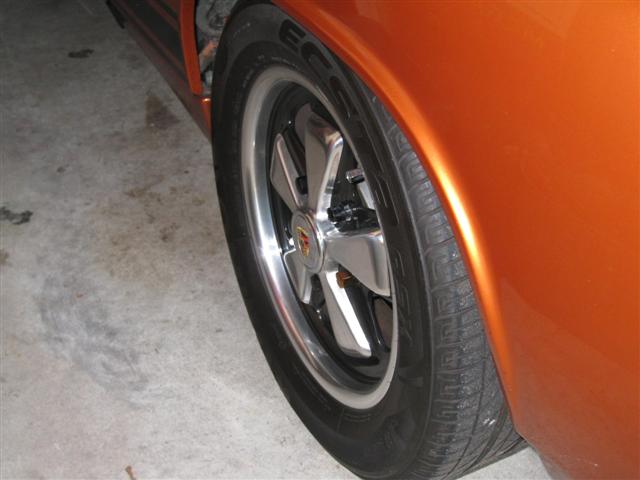

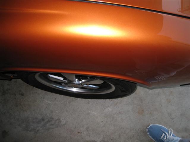

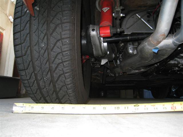

Came across a 7 x 16 944 Turbo Fuchs today and tried a test fit---unfortunately, the rim lacked a tire, so when I did a test fit, it was hard to tell. The 944 turbo wheel has a much greater backspace that a 911 Fuchs.
I know some run these on narrow body cars, please chime in. I have an option on 3 more of these. See pics: Attached image(s)

effutuo101 I am running some 944 turbo phone dials on mine. b... Dec 2 2009, 06:36 PM
ahdoman Hey jim,
My yellow car had those same wheels. I ha... Dec 2 2009, 11:14 PM
underthetire I'm running 16X7 dials with spacers. No real p... Dec 3 2009, 12:16 PM
sixnotfour 17x7 repos with big backspacing
http://www.thesamb... Dec 11 2009, 03:21 AM
jim_hoyland
http://www.thesam... Dec 11 2009, 08:24 AM
computers4kids Jim, I'm running 16 X 6 on the fronts, 16 X 7 ... Dec 11 2009, 08:37 AM
jim_hoyland
Jim, I'm running 16 X 6 on the fronts, 16 X 7... Dec 12 2009, 10:03 AM
burton73 This is the look of factory 7” Fuchs with 911 o... Dec 12 2009, 01:33 PM
sean_v8_914 16x 7 that came thru SandS needed a tug and a roll... Dec 12 2009, 03:07 PM![]() ![]() |
