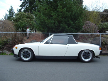

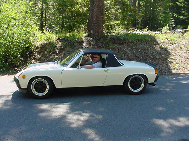

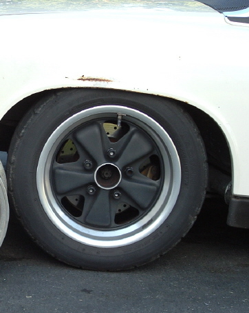

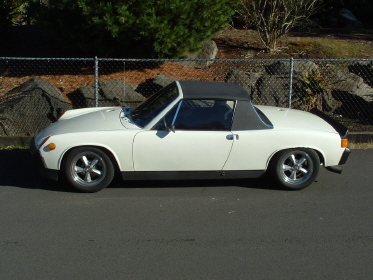

QUOTE The 944 turbo wheel has a much greater backspace that a 911 Fuch The 16x7's all have the same backspacing. The 16X8 has a greater backspacing than regular 911 fuchs. You will have the same issues with these sevens as any other porsche seven.(except911r fuchs) depending on ride height, tire brand/size, alignment specs , etc. here is 16x7 and 16x8 951's 225/245 next all 951 sevens 205 next all 15x7 215/60 next 15x7 fuchs 205/50 note fender rub lightly rolled. Attached image(s)
