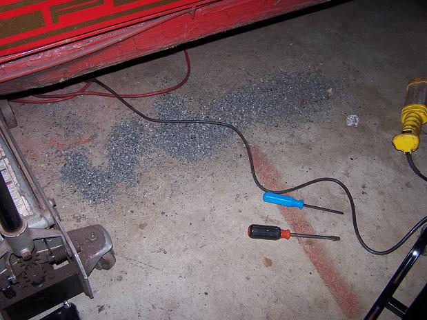

I finally got the car turned around in the garage so the driver's side is accessible.
Jobs in front of me right now:
Pull all the carpeting out of the driver's side interior.
Repair clutch tube and firewall.
Remove and repair rust holes around the driver side triangle plate and floor.
Clean up all the tar and undercoating in the engine compartment and paint
Remove driver rear suspension for painting and check for rust on the suspension console.
Repair driver side outer long (pictures coming)
I bought the car in Oct 2003 and this is the first time I've removed the driver side rocker panel. There was about 5 LB of gravel hiding in the rocker panel.
