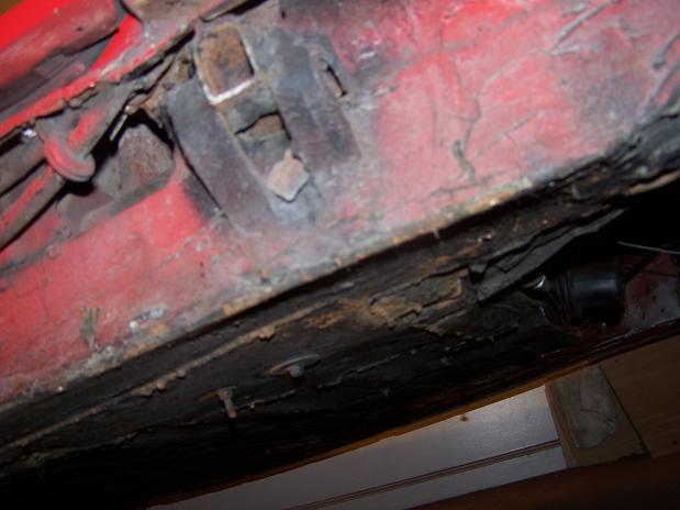

This side was also repaired like the passenger side with a big plate of steel and wrapped around the bottom of the long. That is a big hole in the long and just above it is a piece of tinfoil which I think was used to hold bondo on when the fender was repaired.

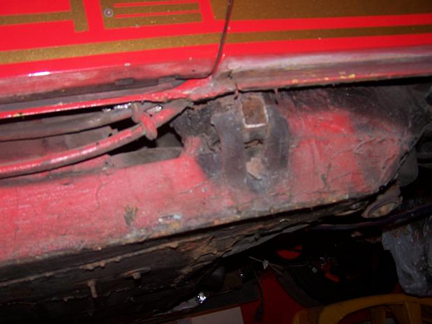

WTF half-assed repair is this on the jack point. It is very flexible and basically unusable. The top of the jack tube support plate is still there but the bottom has rusted away.

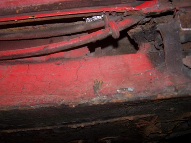

The gas tank vent hoses have some sort of grommet on them. Where would these grommets go?
Close-up of the hole. Looks like I'll be taking off the sill plate and cutting the corner of the fender off to get access to the jack point.
However, the long at this point is relatively rigid so I will postpone the long corrective surgery until after the engine is back in. This way I can get the car on the road and as the long is repaired, I will have the correct pressure on the long to make sure the body dimensions don't change.
