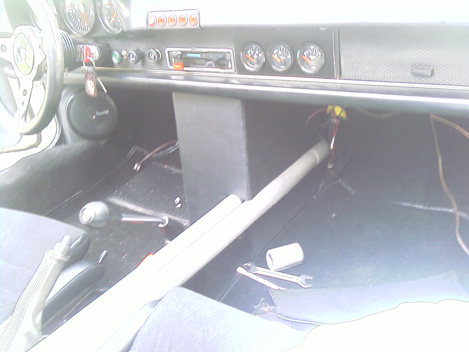

That's exactly why my car has the handbrake in the middle ( old type VW Golf style handbrake.) Works like a charm.
Not the best picture ( pretty old picture now), but you can see it here:

JJ914GT   The PO installed it before I got the car, so didn...   Dec 3 2009, 04:13 PM
