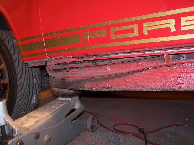

Thanks for the photo Rob.
I think I'm missing part of the bulkhead behind the front wheels. Can I get replacement metal for this or must I fab it myself?
