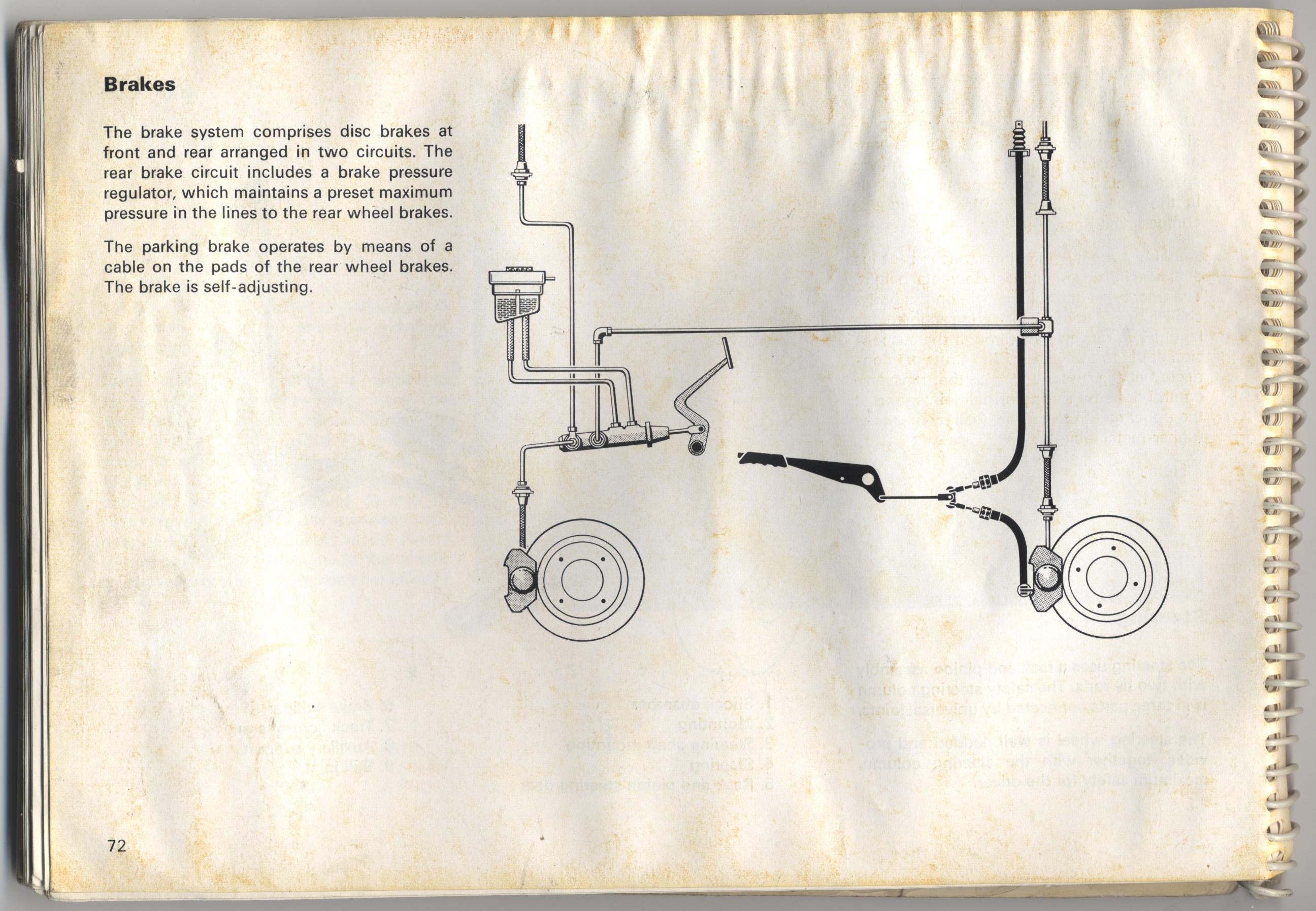

From the owners manual:

SirAndy   From the owners manual:   Dec 4 2009, 12:53 PM
