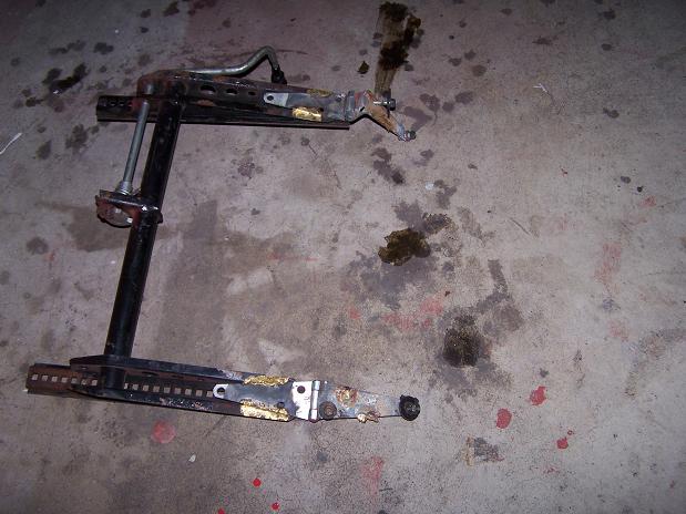

Here's the Ace Hardware seat pivot repair. Not pretty but it works. I'm not planning on changing this.
BTW, can you tell where I park my 911?

QUOTE(Spoke @ Dec 5 2009, 02:18 PM) *
OK that is pretty funny, I was thinking of the "build it on a budget" banner but "bodge it on a budget" is probably more appropriate.
That driver side rocker looks scary.
Nice work, great pics too !
