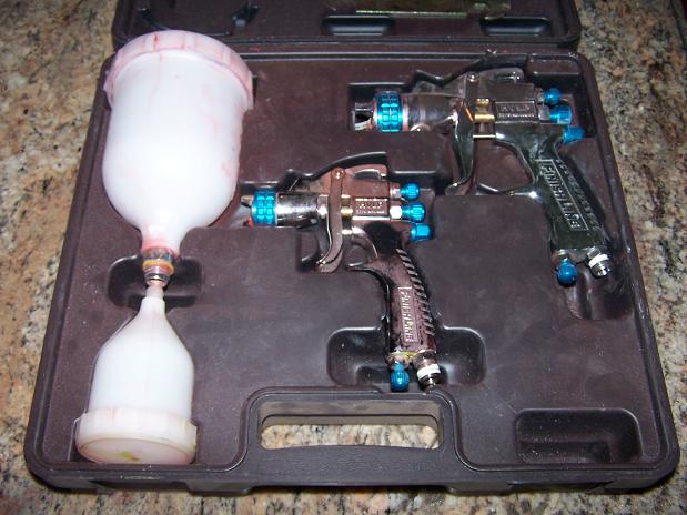

Hey man, did you use an airbrush when you painted inside the fender? What kind?

QUOTE(sendjonathanmail @ Dec 5 2009, 10:19 PM) *
I used the small gun. I picked this DeVilbiss kit up at Eastwood.
