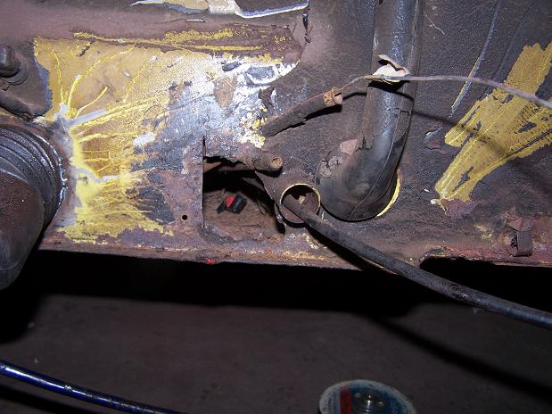

The clutch tube was repaired before as there is a bunch of weld material built up around the tube. The problem is the weaken-by-rust firewall around the tube ripped.

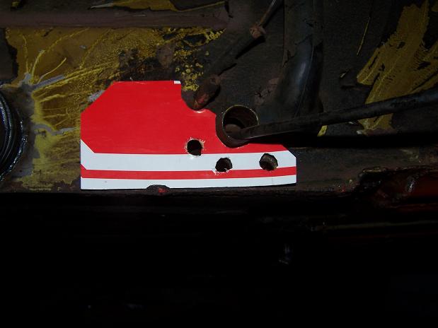

Made a template for a replacement piece. This piece will be quite detailed as it will have 3 holes; one for the tube and 2 for the fuel lines. I'll make the piece out of 14 ga to be sure there is enough strength. I knew my "Stop Walmart" signs would come in handy. (IMG:style_emoticons/default/dry.gif)

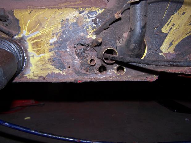

To remove the tube, I had to make only one vertical cut to the left of the tube as the rest of the metal had already ripped.
