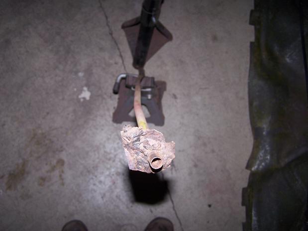

So what shape should the clutch tube have? This one looks like it has a jog around the shifter.

Spoke   The clutch tube was repaired before as there is a ...   Dec 6 2009, 08:51 AM
Spoke   So what shape should the clutch tube have? This on...   Dec 6 2009, 10:13 AM
