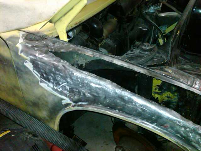

wayne1234   Finally got some more work done with a buddy helpi...   Oct 31 2009, 08:38 PM

wayne1234   Welded up a couple of bondo spots that had nothing...   Dec 4 2009, 02:56 PM
SirAndy   Oh man, every time you post another picture, it ju...   Dec 4 2009, 03:01 PM

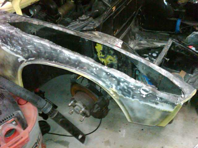

wayne1234   Also major progress.. We got the passenger inner f...   Dec 4 2009, 03:07 PM
wallys914   Also major progress.. We got the passenger inner ...   Dec 5 2009, 03:03 AM

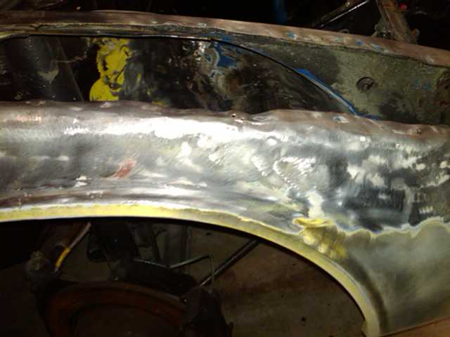

wayne1234   Well we got the front slope nose back into shape t...   Dec 5 2009, 12:07 AM

wayne1234   Wow we have been putting in the hours on the 914. ...   Dec 12 2009, 02:25 AM
wayne1234   Before After :smash: Some of the PO handy work...   Dec 12 2009, 02:35 AM
wayne1234   Success :trophy: The start of the sill plate mes...   Dec 12 2009, 02:41 AM
wayne1234   This is grafic :evilgrin: He though to hims...   Dec 12 2009, 02:50 AM
wayne1234   New metal :cheer:   Dec 12 2009, 02:53 AM
jd74914   Its looking great Wayne! The slope nose is rea...   Dec 12 2009, 08:23 AM
Gint   Sheeesh.... What a mess. :agree: Great work c...   Dec 12 2009, 08:53 AM
