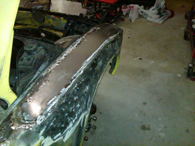

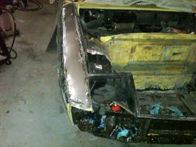

Well, I decided to look into the new car more that I got from a member on here. there was a trunk floor repair that left a little to be desired. I tried using flux cored mig welding and didnt have much luck, so yesterday I got a tank and some gas @ $200 (ouch) and I was doing some survey work on the front trunk. Let me say I was way too excited to get my car and I looked underneath and saw a couple of rust throughts on the passenger side near the rear but the "longs" where I spent most of my 5 minutes looking was solid. and I though no big deal just a couple of pan spots. and under the new battery tray looked solid from the engine compartment. well under the battery tray "hell hole" was described as" not perfect". there is a piece of metal screwed over the bad stuff. making it appear solid. Then the big suprise, there has been por15 used on the motor mount I thought it looked real rough and when i pushed on it with my finger oops a hole. some poking with a screw driver resulted in the hole you see. the I looked further back at the arm that goes to the rear suspension and it is also por15 with a odd look . more poking and you guessed it a hole. I guess some one thinks por15 is structural. NOT,,, Well I dont mind documenting this because I will fix it right. but hopefully my eagerness to finally get my 914 will make someone else take a second look at the car they are looking at. Mine look great in photo's and even pretty good in person. but it had a dark secret. Now the Real question on the motor mount and (trailing arm mount?) guess that's what its called. what should I paint the back of the metal with and what gauge should I use, should I make drain holes so It wont hold water in the future? Im gonna try to do all this welding with the motor in the car. I fear I will never get the car back together if I take out the motor. Thanks for all your input. Wayne

wayne1234   OH NO,,, There is more welding in my future... Wel...   Nov 19 2009, 10:39 PM
wayne1234   RE: WOW, my "solid" car aint so solid, but now it is solid!   Nov 19 2009, 10:42 PM
Ferg   :blink: were those lower gaps/holes covered with...   Nov 20 2009, 02:08 PM
wayne1234   No they were covered by that light blue metal piec...   Nov 20 2009, 04:49 PM

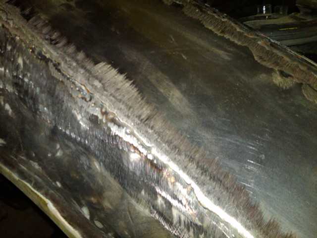

wayne1234   Welded up a couple of bondo spots that had nothing...   Dec 4 2009, 02:56 PM
SirAndy   Oh man, every time you post another picture, it ju...   Dec 4 2009, 03:01 PM

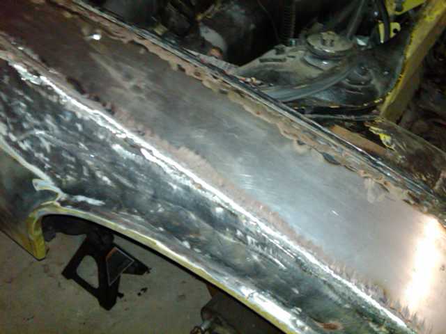

wayne1234   Also major progress.. We got the passenger inner f...   Dec 4 2009, 03:07 PM
wallys914   Also major progress.. We got the passenger inner ...   Dec 5 2009, 03:03 AM
wayne1234   Well we got the front slope nose back into shape t...   Dec 5 2009, 12:07 AM

SirAndy   I know its a small piece , but it was curve and w...   Feb 12 2010, 02:15 PM
