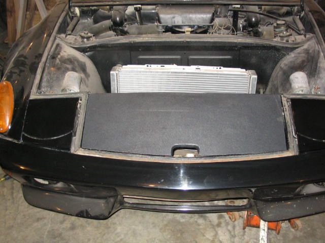

working on the shrouding and baffling for my Howe double pass radiator. It's made from thermo-formed ABS plastic. Still not done but getting closer.
