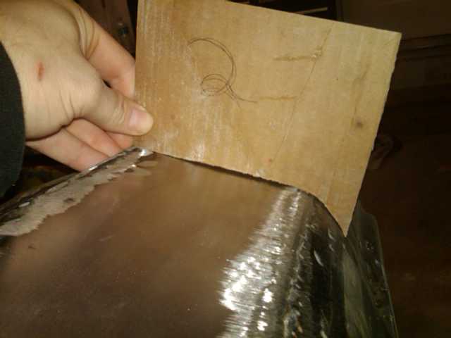

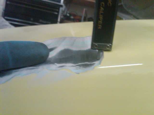

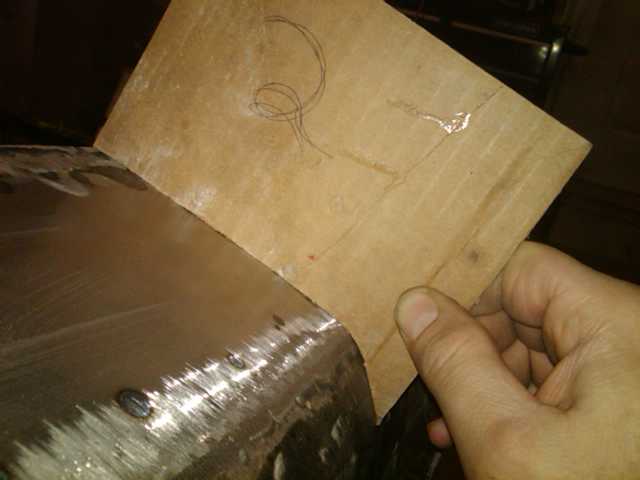

PanelBilly   Did I understand you correctly? You sanded and the...   Feb 12 2010, 02:40 PM
wayne1234   Yeah there was a crack in mine So I used the hobby...   Feb 12 2010, 03:09 PM
