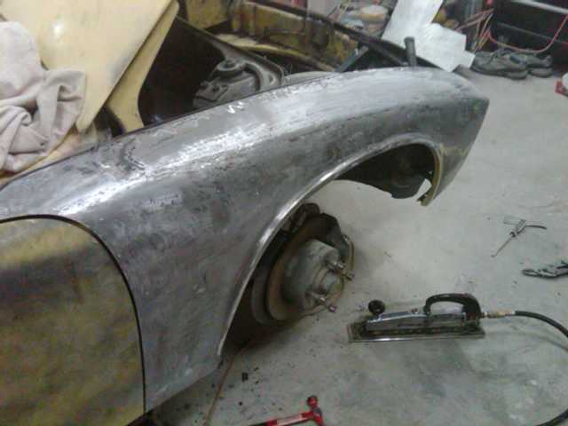

wayne1234   Well we got the front slope nose back into shape t...   Dec 5 2009, 12:07 AM
wayne1234   RE: WOW, my "solid" car aint so solid, but now it is solid!   Dec 5 2009, 12:09 AM

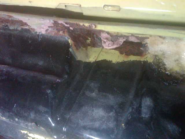

wayne1234   Before After :smash: Some of the PO handy work...   Dec 12 2009, 02:35 AM

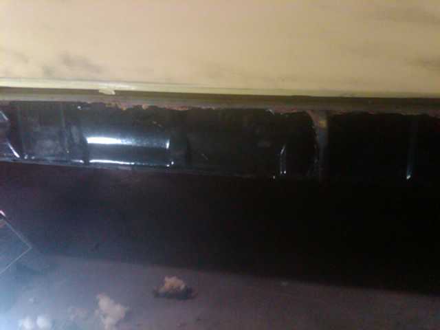

wayne1234   Success :trophy: The start of the sill plate mes...   Dec 12 2009, 02:41 AM
wayne1234   This is grafic :evilgrin: He though to hims...   Dec 12 2009, 02:50 AM
