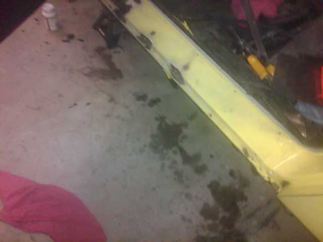

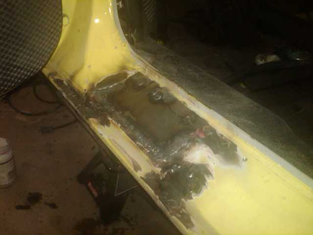

wayne1234   Wow we have been putting in the hours on the 914. ...   Dec 12 2009, 02:25 AM
wayne1234   Before After :smash: Some of the PO handy work...   Dec 12 2009, 02:35 AM
wayne1234   Success :trophy: The start of the sill plate mes...   Dec 12 2009, 02:41 AM
wayne1234   This is grafic :evilgrin: He though to hims...   Dec 12 2009, 02:50 AM
