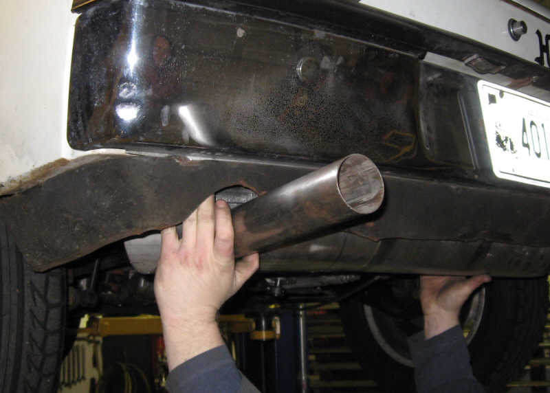

Here's a view of the partially built protptype muffler being test fitted to my car. So far everything is perfect. The muffler will weigh 27 lbs vs. more than 28 for the Dansk 2 in - 2 out we have here.
I think everyone elses mufflers have only one inlet size. Ours will be sized to match the header it goes to.
