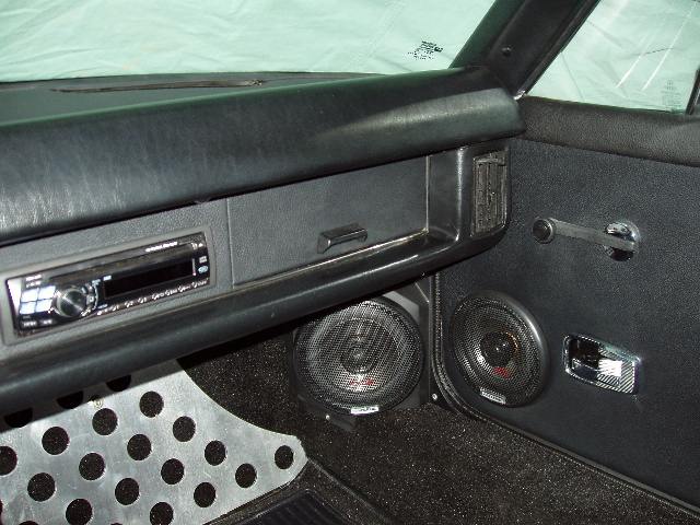

I have one of the amps mounted under the dash stereo, and the other inside the gauge console, the 5.25's are driven by the head unit.
Sub enclosures are a pair of Stainless steel mixing bowls recessed into the firewall. Attached image(s)
