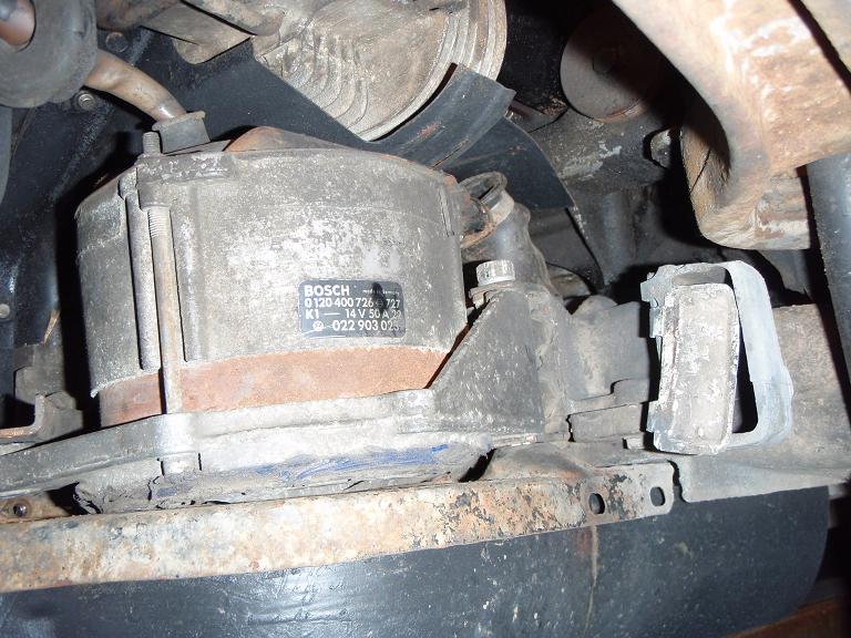

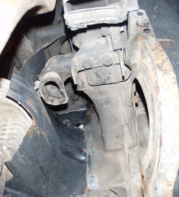

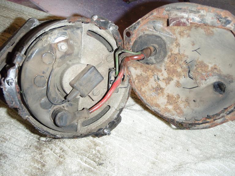

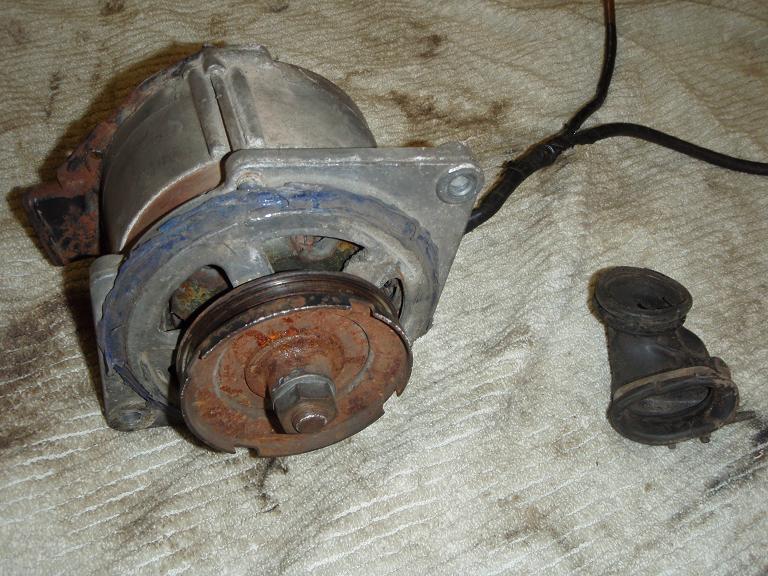

figured i would post the pics of my swap. Basically I orderd a VW bus 75 amp alternator brand new. Got it wound to 120 amps, got Jeff Bowlsby to make me a custom harness with 2 runs of 8guage to handle my maddness. Got a few much needed parts from Detoxcowboy and my plastic seal from the samba.
have a look.
Picture of the original 55 amp alternator in its snug home
Click to view attachmentPicture of the original 55 amp alternator stolen from its home
Click to view attachmentPics of the alternator, inside and out and the krusty boot
Click to view attachmentClick to view attachment

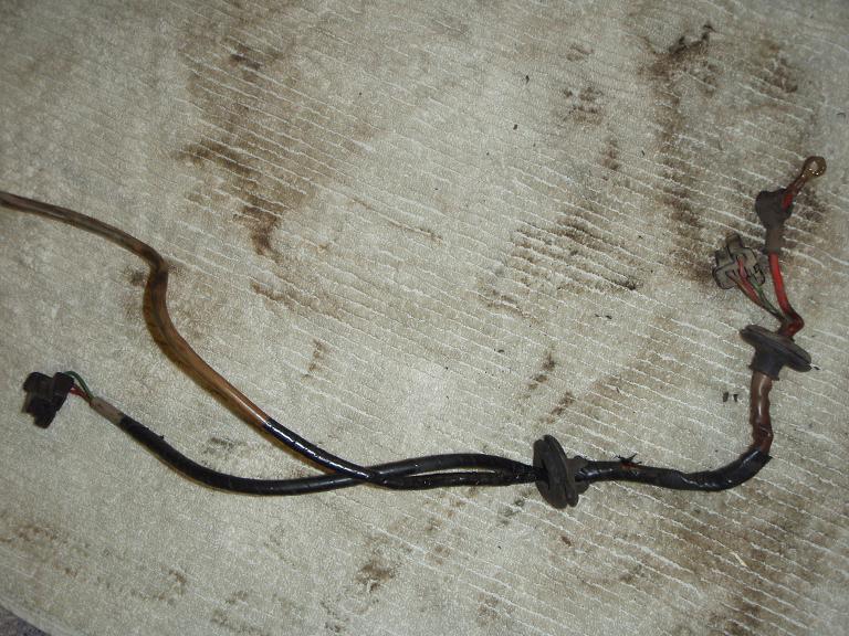

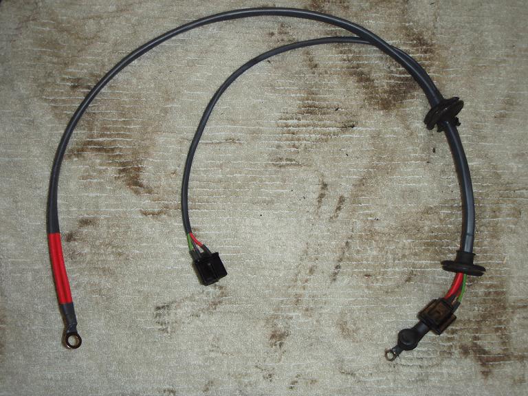

Picture of the old harness and the new harness
Click to view attachmentvs (thanks Jeff)

side by side comparison 55 amp vs 120 amp
jsayre914
Jan 12 2010, 09:53 AM
Then to get the pullys off it is a little tricky, but with the (world) i got some tips
jsayre914
Jan 12 2010, 10:00 AM
Now that they match, I painted the pulley so it would be pretty
jsayre914
Jan 12 2010, 10:05 AM
The Bolt was a little tight so had to be adjusted (with the hacksaw)
jsayre914
Jan 12 2010, 10:07 AM
The Final result, looks almost stock and fits exactly like the old one, with the new rubber boot it fit perfectly.

Jan 12 2010, 02:14 PM
Any way you could have kept the cooling fins? Would seem like a good idea ....
Andy
detoxcowboy
Jan 12 2010, 03:19 PM
QUOTE(SirAndy @ Jan 12 2010, 12:14 PM)
Andy
There is alt. tin for the 70 amp alt. style which also hads the pulley fan, basically the 120 amp. alt is a 70 amp alt. wound to 120 amp. (vw bus bosch alt.s) The 55 amp alt. style (stock 914 and some 75 amp alt.s same body desighn) does not have the fan and the tin is diffent and will not work with the fan impeller.. Both tin styles can be found at Samba or elsewhere.. The 55 alt. tin has a smaller opening which will rub on the fan blades, where the 70 amp alt. tin has a larger opening to accomadate the fan blades.. both will mount directly to the 914 stock allighnments..
