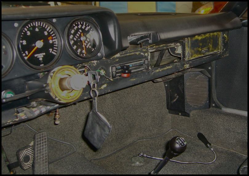

I'm going to eliminate the glove box and the radio. My first thought is to get a flat piece of thin steel (like Porsche used behind the center piece of the dash) that extends from the steering wheel all the way over to the right side where the face ends, and cover that entire piece with the basket weave vinyl. Is that a decent way to execute this? If so, is it correct that it will "sandwich" between the dash top and the knee cap piece, as well as being glued? If so, can i slide it under the dash top or does it need to be removed?

With the bottom dash removed, these pieces are easily installed using double-sided tape to hold the metal to the dash. Not sure how to attach the metal plate over the radio and glovebox holes.
Why no glovebox? I would assume the radio will go somewhere else or replaced by an iPod.

Might eliminate the glovebox just for "cleanliness". I thought about an iPod, but might just go with no tunes...just the engine sounds. How does the ventilation control unit come out?

QUOTE(kenshapiro2002 @ Dec 14 2009, 12:06 PM) *
10mm nut on the backside, slides out the front. Bunch-O-Wires-N-Cables attached to it as well ...

Either different on a 1970, mine's missing, or I'm blind. Couldn't find any retaining nut at all. In fact, can't find any way the unit is held in place unless it's merely pressed in there and held in place by the dash itself. The chrome trim strip simply had four horizontal tabs that inserted into corresponding slots in the ventilation unit itself. Anyway...no problem getting it out. Just finished using the angle grinder with a wire wheel to clean up the dash and the metal plates that will get recovered. Out to buy trim adhesive and double sided tape. Damn I'm productive! Retirement rocks!
Look harder ... (IMG:style_emoticons/default/rolleyes.gif)
There's a tab on the backside that is bolted to a stud on the front firewall using a 10mm nut. (10mm being the wrench size, not the thread size) ...
