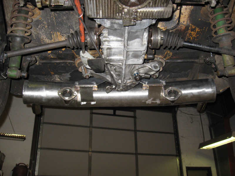

First prototype of a critical component:

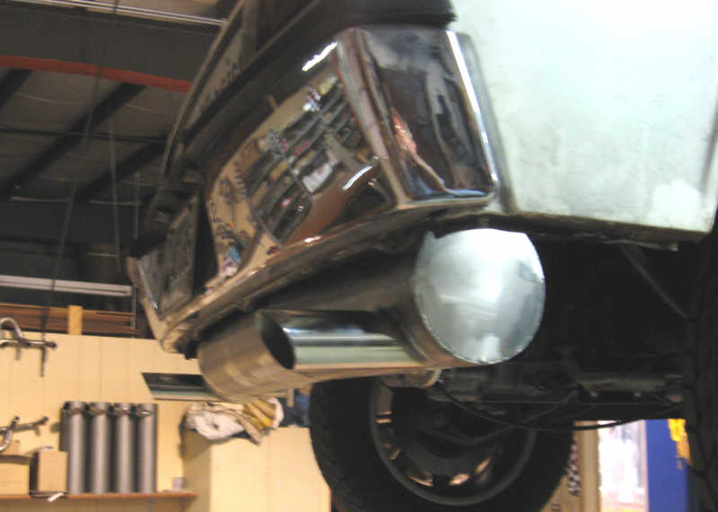

Muffler's done. It will fit behind a WEVO 915.

Racer Chris   Here's a view of the partially built protptype...   Dec 12 2009, 08:45 AM
Racer Chris   Muffler's done. It will fit behind a WEVO 915.   Dec 15 2009, 06:23 PM
jgara962   Any thoughts to making that same looking muffler b...   Dec 15 2009, 10:06 PM
Racer Chris   Any thoughts to making that same looking muffler ...   Dec 15 2009, 11:40 PM
jgara962   Any thoughts to making that same looking muffler...   Dec 16 2009, 09:30 AM
Racer Chris   A simmilar looking muffler that connects to a hea...   Dec 16 2009, 09:59 AM
736conver   Looks like an MK exhaust muffler.   Dec 16 2009, 12:29 AM
Racer Chris   Looks like an MK exhaust muffler. The only thing...   Dec 16 2009, 06:40 AM

Racer Chris   On the six cylinder front: Yesterday I realized th...   Dec 17 2009, 12:36 PM
9146986   So why up and over the half shafts? Not being cri...   Dec 18 2009, 12:55 PM
Racer Chris   So why up and over the half shafts? Nathan is p...   Dec 18 2009, 03:23 PM
JmuRiz   I'm guessing it has to do with the desired len...   Dec 18 2009, 01:07 PM
