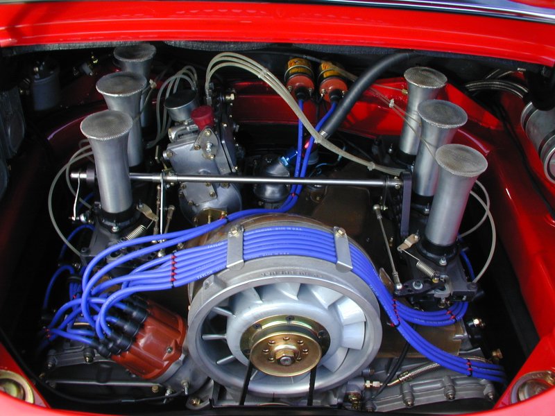

No... What I need is something like THIS!!!!
![]() (Did I mention that I hate carburetors??) |

No... What I need is something like THIS!!!! ![]() (Did I mention that I hate carburetors??) twin plug motors are so sexy (IMG:style_emoticons/default/smile.gif) |
