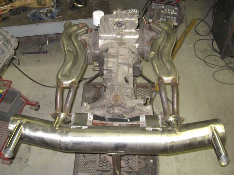

First prototype of a critical component:
ChrisFoley
post Dec 16 2009, 06:53 PM
I am Tangerine Racing
Posts: 8,006
Joined: 29-January 03
From: Bolton, CT
Member No.: 209
Here's what the new muffler will look like with SSI heat exchangers on a four cylinder. The rear flanges of the SSIs will be removed and the pipes altered to connect with the muffler, which will be moved a little closer. The one shown is set way back to clear a WEVO on a -6.
By separating the primaries from each other it should be easier to seal them against the heads.
All 4 primary pipes will enter the muffler separately to eliminate negative sound reflections from going up the wrong pipe, and maintain the shortest possible lengths. Even though the pipe lengths will be unequal, I predict that this will produce more power than anything short of a full header system.
We should have the test system completed in a couple of days.

KevinP   Chris, I have always wondered why we have had to ...   Dec 10 2009, 08:33 AM
dflesburg   cheap heat for my six conversion   Dec 10 2009, 09:26 AM
JmuRiz   So this is for an exhaust scavenging header like y...   Dec 10 2009, 10:24 AM
Racer Chris   So this is for an exhaust scavenging header like ...   Dec 10 2009, 11:55 AM
JmuRiz   Cool stuff, can't wait to see the results, in ...   Dec 10 2009, 01:14 PM
Travis Neff   Are you planning to do any pre-post dyno work?   Dec 10 2009, 08:06 PM
Racer Chris   Are you planning to do any pre-post dyno work? N...   Dec 11 2009, 10:16 AM

jgara962   Any thoughts to making that same looking muffler b...   Dec 15 2009, 10:06 PM
Racer Chris   Any thoughts to making that same looking muffler ...   Dec 15 2009, 11:40 PM
jgara962   Any thoughts to making that same looking muffler...   Dec 16 2009, 09:30 AM
Racer Chris   A simmilar looking muffler that connects to a hea...   Dec 16 2009, 09:59 AM

Mark Henry   The firing order of a six essentially means the...   Dec 16 2009, 02:38 PM
Mark Henry   Is there a reason that most N/A systems are done (...   Dec 16 2009, 05:09 AM

Sparky   *SIGH* I was hoping this was the base and collecto...   Dec 17 2009, 05:38 AM
Racer Chris   *SIGH* I was hoping this was the base and collect...   Dec 18 2009, 12:44 PM
Gint   Cool! What's the plan for having the buye...   Dec 17 2009, 07:37 AM
Racer Chris   What's the plan for having the buyer modify s...   Dec 17 2009, 12:35 PM
Racer Chris   On the six cylinder front: Yesterday I realized th...   Dec 17 2009, 12:36 PM
9146986   So why up and over the half shafts? Not being cri...   Dec 18 2009, 12:55 PM
Racer Chris   So why up and over the half shafts? Nathan is p...   Dec 18 2009, 03:23 PM
JmuRiz   I'm guessing it has to do with the desired len...   Dec 18 2009, 01:07 PM
