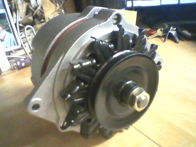

jsayre914   figured i would post the pics of my swap. Basicall...   Jan 12 2010, 09:46 AM

jsayre914   side by side comparison 55 amp vs 120 amp :chow:   Jan 12 2010, 09:51 AM
jsayre914   Then to get the pullys off it is a little tricky, ...   Jan 12 2010, 09:53 AM
jsayre914   Now that they match, I painted the pulley so it wo...   Jan 12 2010, 10:00 AM
jsayre914   The Bolt was a little tight so had to be adjusted ...   Jan 12 2010, 10:05 AM
jsayre914   The Final result, looks almost stock and fits exac...   Jan 12 2010, 10:07 AM
jsayre914   Now I should have just enough power to listen to m...   Jan 12 2010, 10:09 AM
SirAndy   Any way you could have kept the cooling fins? Woul...   Jan 12 2010, 02:14 PM
detoxcowboy   Any way you could have kept the cooling fins? Wou...   Jan 12 2010, 03:19 PM
