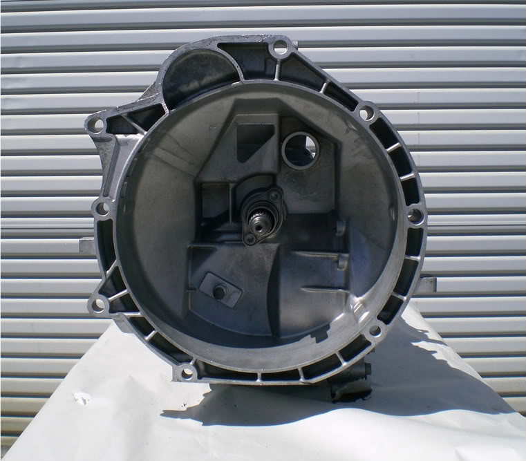

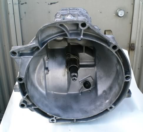

Boxster S 6 speed:
996 transmission:
The side pics show that the flanges are 6 bolt on the Boxster S, and IIRC they have the same diameter as the 930 flanges. (refer to Eric's thread on 'simple' 5 lug conversion for getting the power to the wheels from the trans).

RJMII   isn't the 996 Transaxle the same bolt pattern/...   Dec 21 2009, 07:52 PM
RJMII   Boxster S 6 speed: 996 transmission: The...   Dec 21 2009, 07:56 PM
andys   It would be good to know if the bolt patterns are ...   Dec 27 2009, 11:21 PM
RJMII   I confirmed it with Brad and Jake. =o) the Boxster...   Dec 28 2009, 12:45 PM
ghuff   I confirmed it with Brad and Jake. =o) the Boxste...   Dec 28 2009, 01:20 PM
RJMII   From what I've read (mostly in some of Jake...   Dec 28 2009, 04:51 PM
