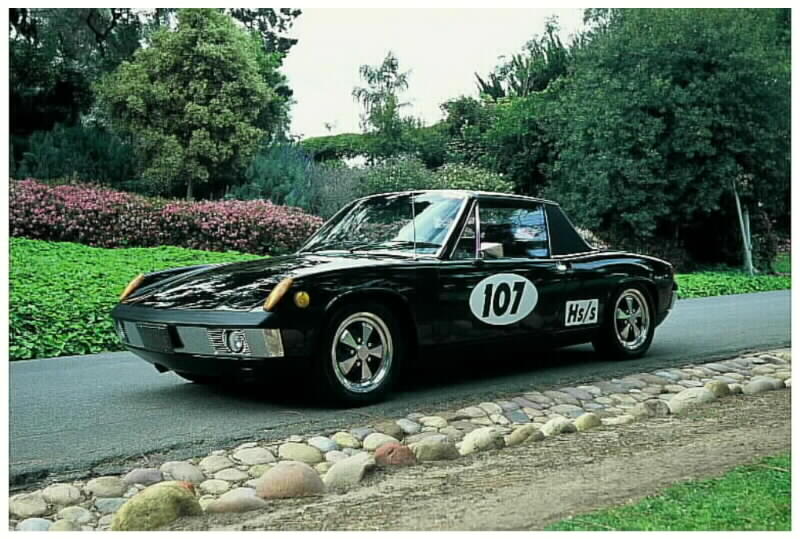

I painted my 6 in the driveway in 2001, the paint still looks great. There are no shortcuts for a good paint job. Good Luck
