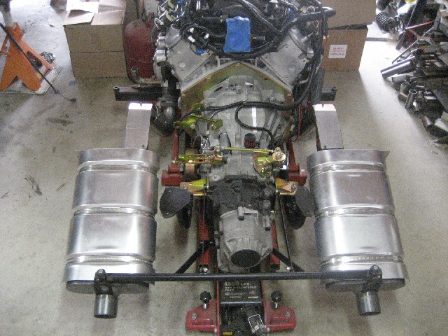

It would be good to know if the bolt patterns are the same, though the two transaxles probably are not unless the Boxster motor rotates in the opposite direction. Kennedy could answer the bolt pattern question.
Having done (well, almost done anyway) an LS1/914 conversion, it takes some doing in terms of fabricating special parts but doable it is. I'd be concerned with the 901 transaxle strength, but that mostly depends on how you drive it; Some people can ruin just about any trans in a heartbeat while others' can make them last just fine. I'm using an Audi 01E 6 speed which some have claimed is good to 500HP, but I'm not anywhere near that anyway. Took a lot of special fabrication to adapt it and to mount it into the car.
The below is a photo before the engine/trans were installed. I did drive the car only once so far just up and down the street; no license plates, no insurance, so I parked it quick.
