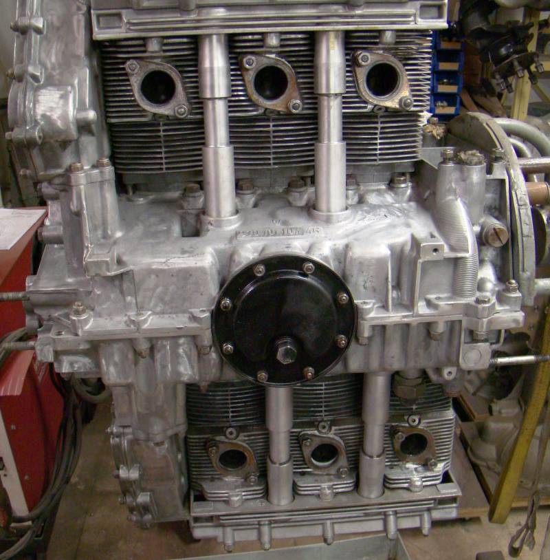

Damn...just got offered another engine (IMG:style_emoticons/default/blink.gif)
79 3.0SC, us spec, guy says it ran fine but doesn't know the history before him. He said he moved up to a 3.2 (now his backup) and he now has a 3.6. He's been using it as his mock-up engine, but doesn't need 3 engines. Waiting for his asking price. Big port heads. All studs are perfect on the intake and exhaust. local.
10 fins, so low cr alusil jugs
What's this worth?
