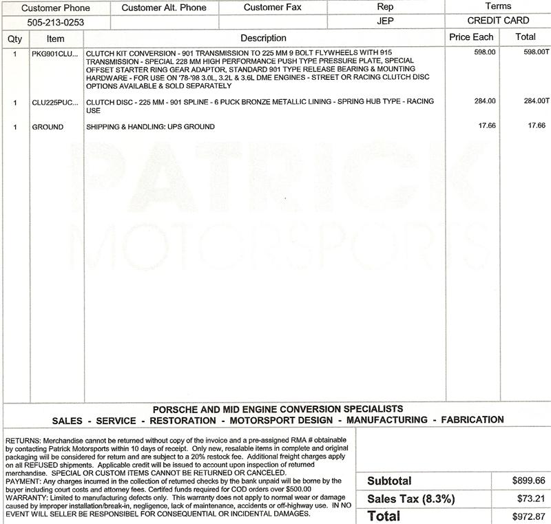

jt914-6
Dec 28 2009, 06:59 PM
Here's a copy of my invoice from Patrick Motorsports dated 4/14/08. Kit for 3.0 flywheel and 901 tranny. Works great even with the puck disc with street use....
rfuerst911sc
Dec 29 2009, 06:16 PM
QUOTE(jt914-6 @ Dec 28 2009, 04:59 PM)
Click to view attachmentWOW I'm glad I bought from Kennedy ! The Patrick setup is pricey.
