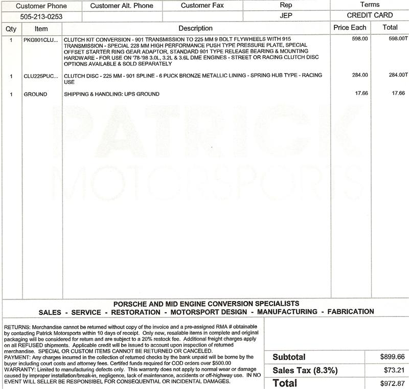

Mark Henry   What is the $damage on that set up?   Dec 28 2009, 03:55 PM
SirAndy   What is the $damage on that set up? I don...   Dec 28 2009, 04:05 PM
rfuerst911sc   What is the $damage on that set up? Here...   Dec 28 2009, 05:54 PM
jt914-6   Here's a copy of my invoice from Patrick Motor...   Dec 28 2009, 06:59 PM
rfuerst911sc   Here's a copy of my invoice from Patrick Moto...   Dec 29 2009, 06:16 PM
