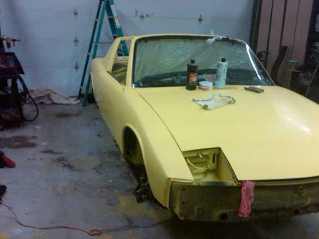

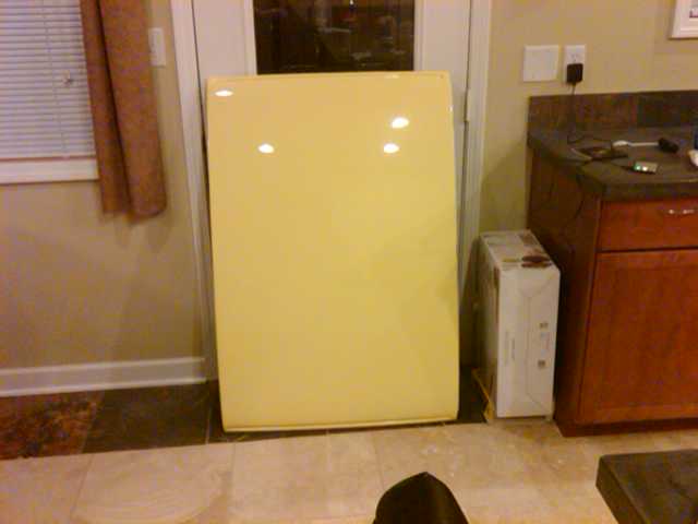

Alot more progress, I finally finished the paint, I ran into some problems since it had been a while since I had done some paint work, Thanks to Rick 918-s, he actually called me over Christmas and helped me out with a problem, talk about going out of your way... Thanks again. The paint came out really nice, I have a couple of spots to buff out but nothing major, The biggest is a condensation drip from my respirator,,, but it will sand and buff out nice< I already got excited and did a quick spot on the hood. Also big news (but no pics sorry) the engine case is back together, the cylinders and heads are also on and the rocker arms are in place, but not adjusted, and I need to finish up the tin and get it painted I think I'm going red.. now I need to do a inventory on the rubber seals I need since the PO did replace some and get them ordered from mike, and I need the carpet, who is good to use for that? here is some pics...

wayne1234   Alot more progress, I finally finished the paint, ...   Jan 2 2010, 12:10 AM

wayne1234   I'm really happy with how the paint is coming ...   Jan 3 2010, 03:08 PM
