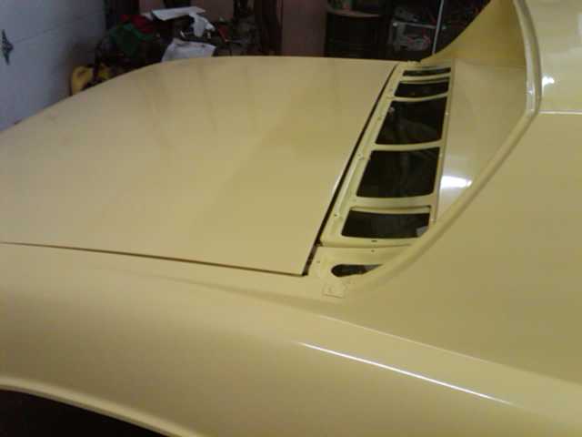

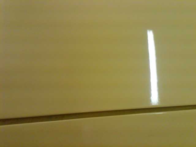

wayne1234   Alot more progress, I finally finished the paint, ...   Jan 2 2010, 12:10 AM

wayne1234   I'm really happy with how the paint is coming ...   Jan 3 2010, 03:08 PM

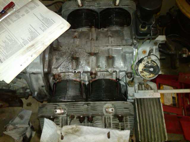

wayne1234   Engine is almost totally together :cheer: couple ...   Jan 6 2010, 02:12 AM
wayne1234   Progress has been SLOW.... the engine is in :D I m...   Feb 12 2010, 12:28 PM
