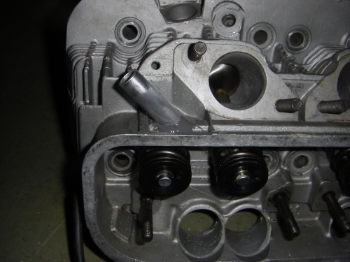

It hit me today that since I'm using L-Jet heads, I need to add venting for the crankcase. Is the best method to drill and tap for a threaded insert?

r_towle   Heads, Drill and tap them for a breather fitting. ...   Nov 29 2009, 07:18 PM
swood   OK, cool. sounds straight forward enough. How does...   Nov 29 2009, 07:29 PM
r_towle   fitting gets mounted the same as the pcv valve...a...   Nov 29 2009, 07:34 PM
Gint   If you can drill straight enough, you don't ha...   Nov 29 2009, 08:00 PM

Racer Chris   I need to add venting for the crankcase. Is the ...   Dec 12 2009, 02:51 AM
swood   I'm pullin the heads to change out the rocker ...   Dec 12 2009, 01:27 PM
swood   X marks the spot? Definitely at an angle away from...   Dec 12 2009, 05:18 PM
Racer Chris   AFAIK all the 914 heads had the boss for the tube....   Dec 12 2009, 07:13 PM
